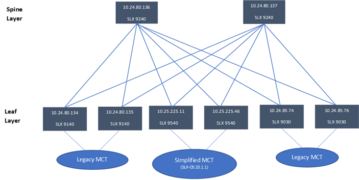

The following figure shows a 3-stage Clos topology.
The following commands configure the 3-stage Clos topology:
efa fabric create --name fabric1
efa fabric setting update --name fabric1 --vni-auto-map No
efa fabric device add-bulk --spine 10.24.80.136 --border-leaf 10.25.225.11,10.25.225.46
--leaf 10.24.80.134-135,10.24.85.74,10.24.85.76 --username admin --password password
--name fabric1
efa fabric configure --name fabric1

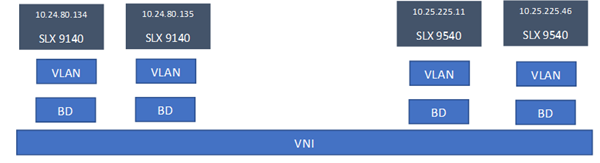

The following figure shows tenant constructs in the Clos Fabric.
Scope of tenant constructs
